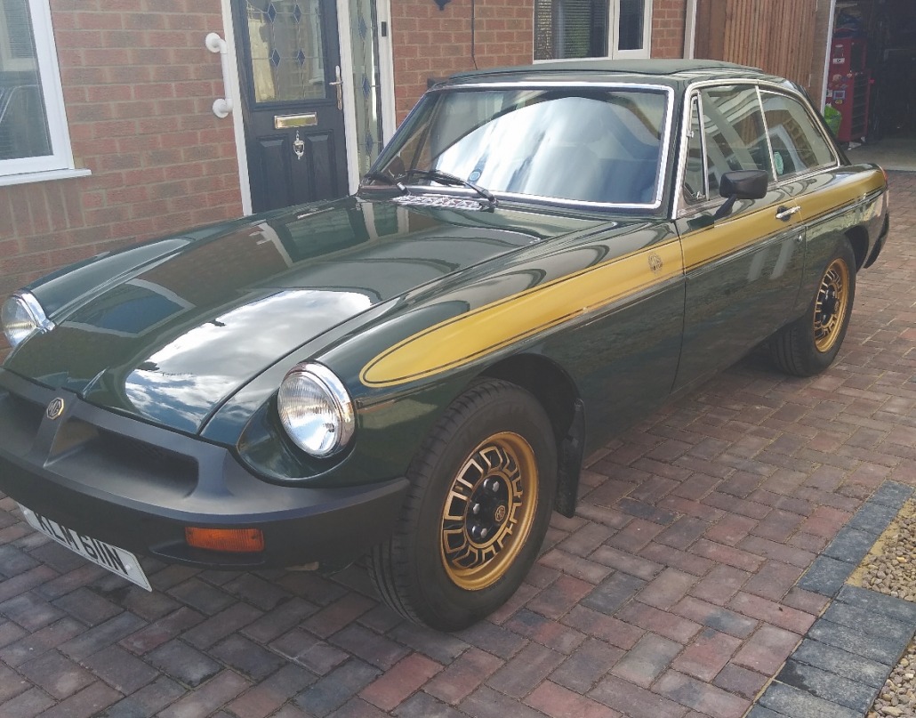

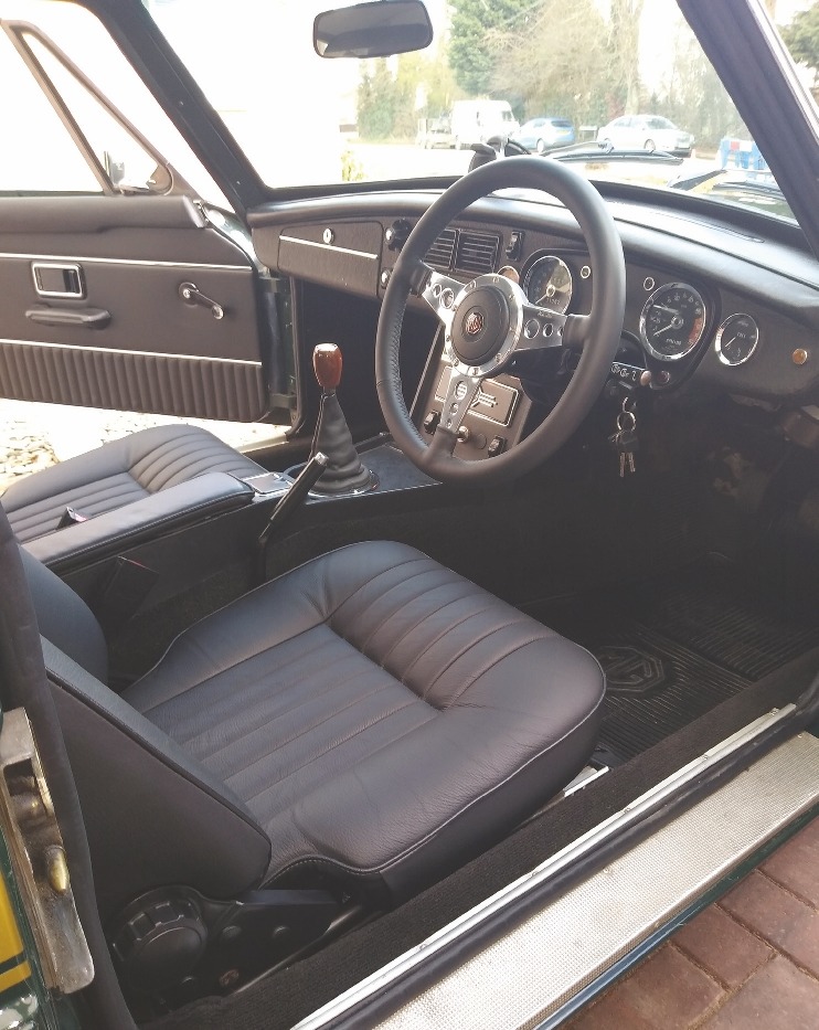

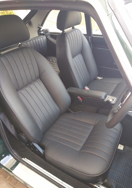

At the beginning of lockdown last year, I looked at my Limited Edition MGB GT Jubilee and thought: “ Oh well, hopefully we will still be able to get in some of our planned outings when restrictions are lifted” . Silly me! Well, that snowballed so I decided to make sure we were primed, ready, and looking our best when we would be allowed to integrate with the world again.
To begin, I totally cleaned the whole underside of the MG then I Schutzed and Waxoyled it inside and out (including under bonnet, door shuts, etc) to help preserve her for future years. Anything that was not 100% perfect was replaced, including a new petrol tank along with petrol cap, fuel pump and pipes. I even treated her to new K & N filters.
I needed to upgrade the wheel nuts; as the Jubilee has V8 wheels I had to source V8 wheel nuts which now compliment the distinctive black and gold wheels.
The inside of the MG also got a spruce-up and refresh with new door cards and trim including chrome door caps, seat belts, new front seats, and a new Moto-lita steering wheel as the Jubilee has a lovely V8 steering wheel with a gold MG boss in keeping with rest of the car, but it is large and cumbersome. I also fitted a top tint windscreen so also had to purchase a fitting kit.
I finished it all off with a whole new set of door locks. I have recently replaced the battery and earth lead, too.
Lots of work and expense but totally worth every penny and moment of my time.

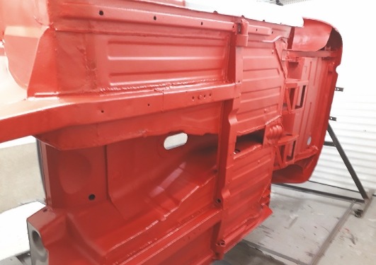

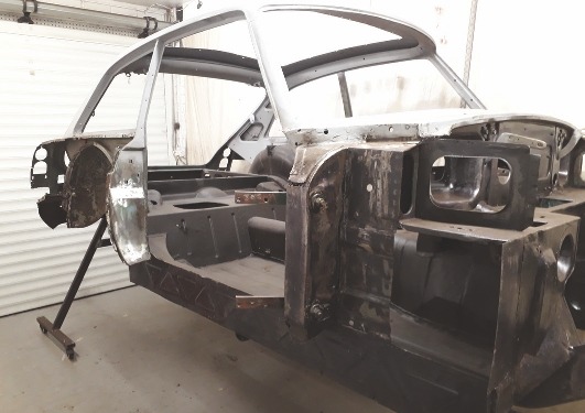

Although the car was running it showed the usual signs of rust in all the usual places, so after trailering the car home I started to strip her to find the extent of the work required. The car came apart quite quickly and my list of repairs grew rapidly. At this stage I decided that the work required would be far easier to carry out if the body was mounted on a car turning jig. So I took time off to design and manufacture a jig. As I had completely stripped the car to just the shell, it was reasonably easy to mount on the jig. Once on the jig I realised I had made the right decision – I could spin the body with little effort into the correct position for working on.
Many months passed as I worked through the weld repairs and new panel fitting, ensuring good panel gaps. Luckily I managed to borrow a spot welder which helped enormously. Once satisfied, I sprayed the shell in acid etch primer.
It was now time to look for a suitable chassis coating; I was recommended UPOL Raptor. Raptor provides a tough, durable, long-lasting protection and by adding base coat body colour to the mix, the underside can be spraying body colour in one.
Now I could refit the newly restored suspension, springs, shockers and back axle to the chassis so I could remove the body from the jig and place it back on its wheels. When building up the suspension I used all poly bushes in touring hardness quality. At the rear I have used Parabolic springs and Gaz adjustable shockers.
It had taken me almost 18 months to get to this point and I was looking forward to getting the shell off to the painters. Although POPPY came off the production line in December 1970 painted in Midnight Blue, I decided that I would paint it Flame Red, equally a 1970/71 paint colour.

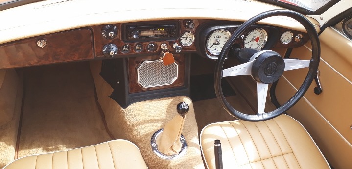

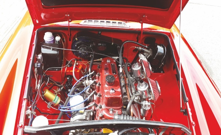

On the downward slope now, I fitted the rebuilt engine/gearbox back in the car and moved on to the interior. I decided to change the interior colour from black to biscuit. I bought a complete kit from “ Mirror Trim” and rebuilt the seats myself, which I have to say was easier than I imagined.

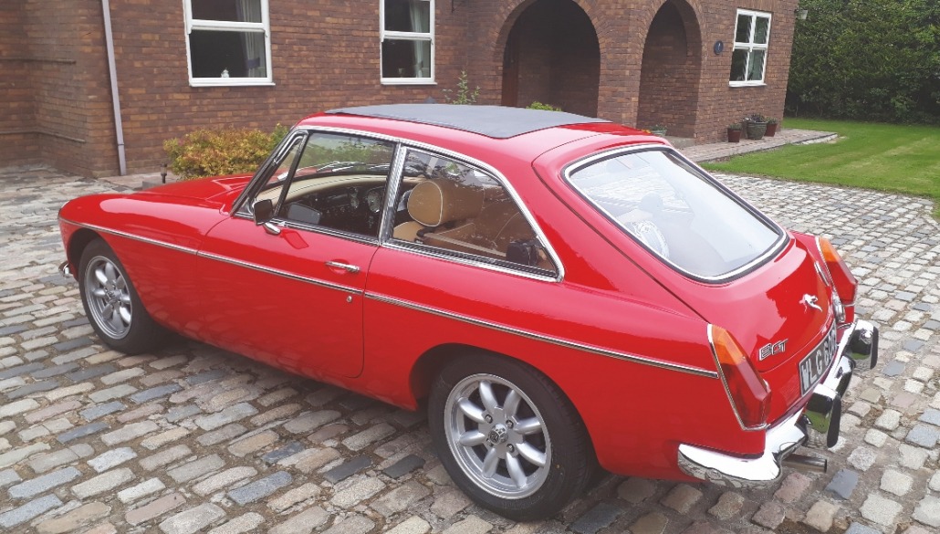

In total the restoration took me three and a half years and she now has 500 miles on her. The last year of Covid has curtailed our enjoyment, as Poppy the MGB GT sits in the heated garage. Hopefully it will soon celebrate its 50th birthday in the summer sun this year. We are looking forward to the MGB Register weekend away in September at the Barony Castle hotel in Scotland.
