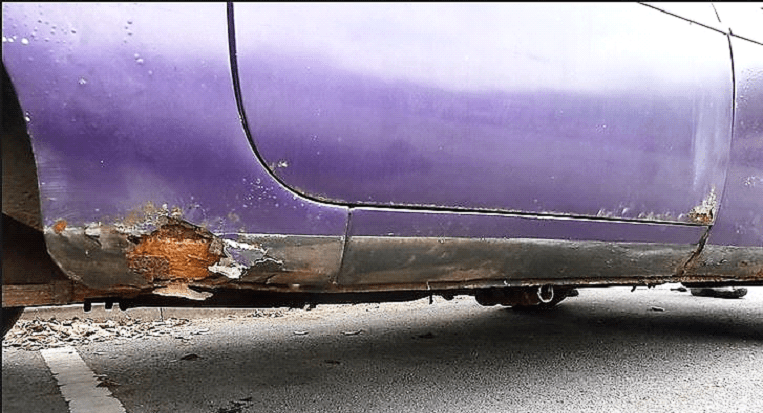

In April 2015, the MG Car Club received an anodyne email which could have easily ended up in the trash. Indeed, it seemed of little interest as a second-hand dealer reported having recently cleared a large house and that he had found an MGB convertible with a fair amount of rust… Just another MGB it seemed which reappears too late to be saved. This though did not stop the author of the e mail to asking for £1000. … Was this really of no interest?
However, fortunately the photo of the sorry-looking car was seen by a certain Bill Price. The latter is a member of the MGCC but not just any member, he is a former director of the BMC Competition Department. He clearly identified two accessories as being parts supplied at the time by his department: the half-roll bar, and the additional spare wheel support on the boot. The club’s archivist (Peter Neal) then researched the registration number of the car, the famous UMD 534F. Very quickly, the link was made with the MGB entered in the London-Sydney Marathon by the mixed crew of Jean Denton / Tom Boyce.

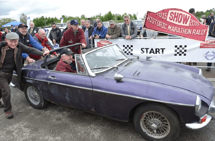

Given the historical interest of the car, the MGCC acquired it. The virtual complete reconstruction it needed represented a substantial budget and the MGCC launched a subscription fund in order to restore it. Superficial cleaning was carried out in order to present the car “in its juice” at the Historic Marathon Rally Show in Gaydon, May 31, 2015. Both amateurs and experts could discover the car and contribute financially to the project.

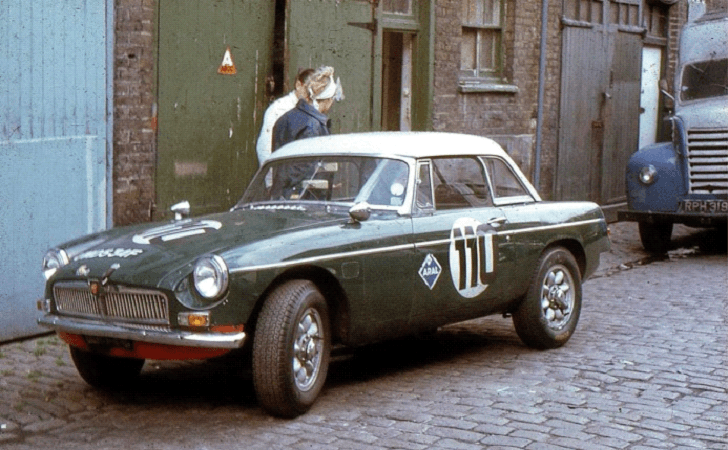

This BRG B roadster had been delivered at the beginning of the year by “Abingdon Special Tuning” on special order from Syd Enever. The body had already been reinforced by the factory and Tom had prepared it further for European long distance road rallies. His assignment to the London-Sydney event necessitated a reorientation of his preparation.

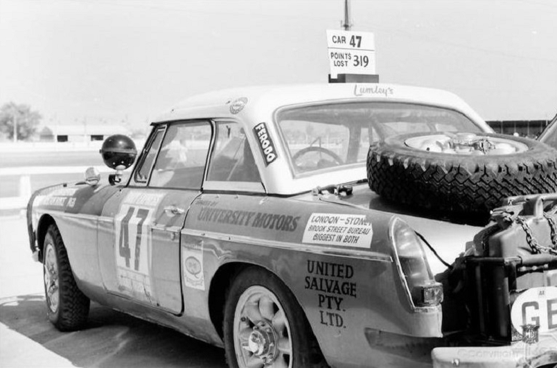

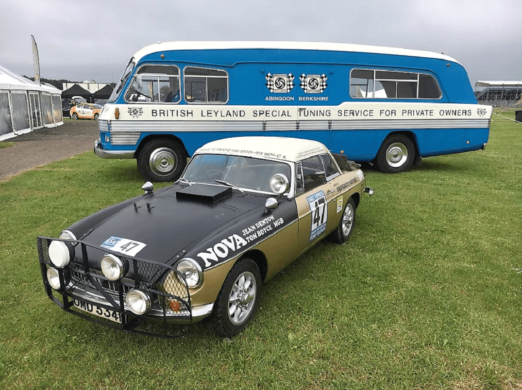

Work included balancing the engine and adapting a slightly sharper camshaft and modification of the cylinder head to lower the volumetric ratio in order to accept poor quality gasolines. Also, the creation of two louvres on each side at the rear of the bonnet to limit the accumulation of heat in the engine compartment (picture 1) ; the elimination of one strip in two to increase the air intake through the grille ; the installation of a second coil ready to be connected.

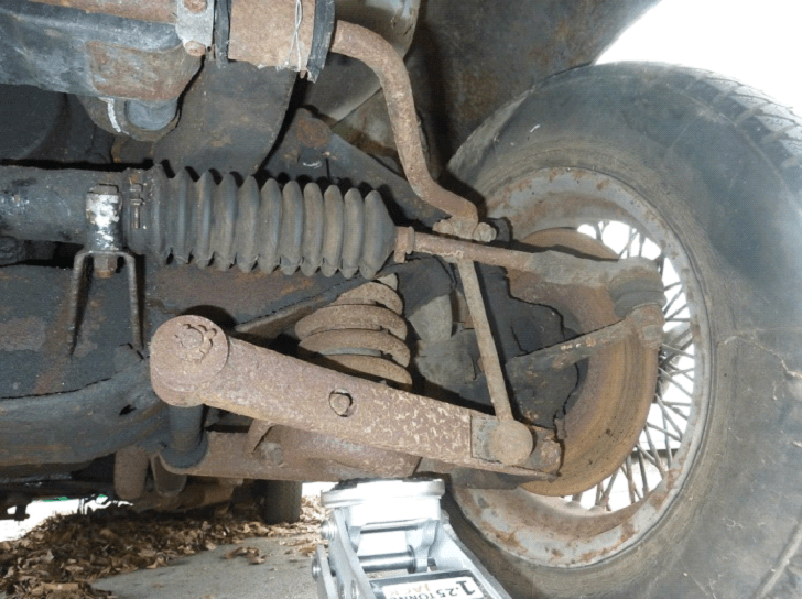

Reinforced rear suspension springs with 8 blades instead of the usual 6 may be seen below – supplemented by combined coil springs / telescopic shock absorbers, and the addition of robust rubber stops. Tom Boyce utilised an existing system, already implemented on police MGBs with particularly heavy radio equipment.

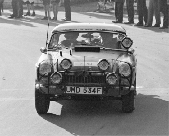

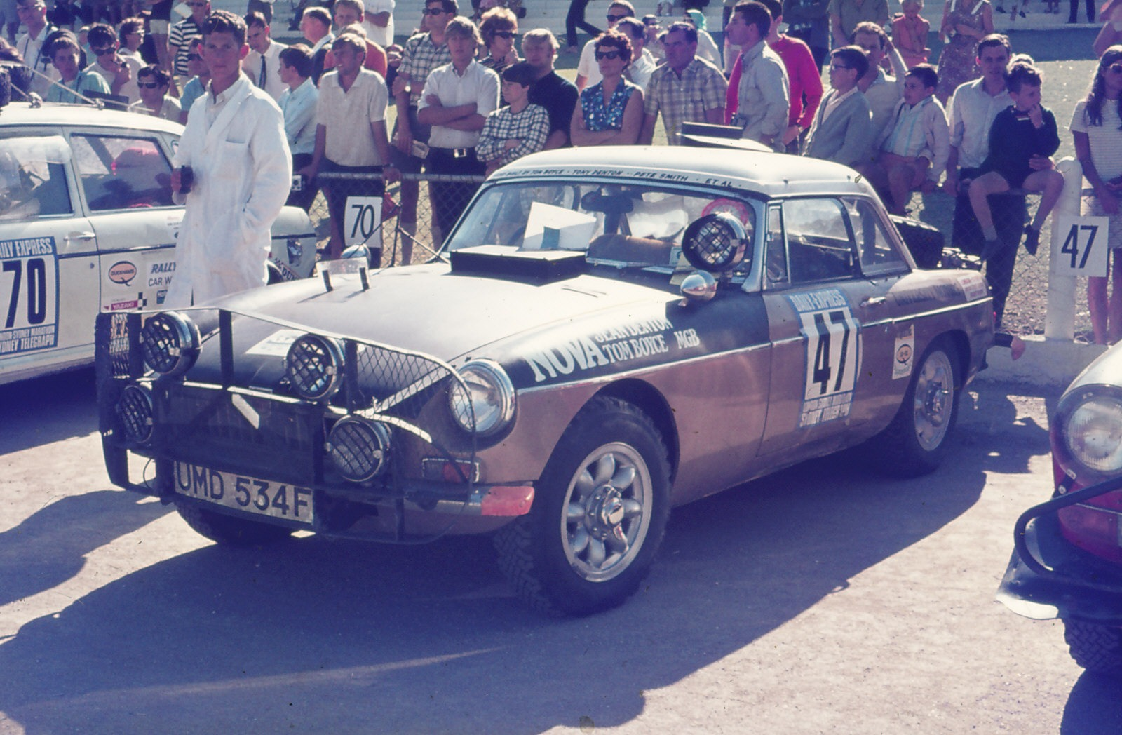

The installation of an imposing bull bar at the front may be seen. Also, large additional Cibié headlights, 4 in number: 2 fog lights and 2 long range. A co-pilot adjustable lighthouse completed the night equipment.
Fitting a hard-top and a safety hoop. Mounting particularly sturdy Dunlop tires. Jean and Tom had only two punctures throughout the course.
Fuel

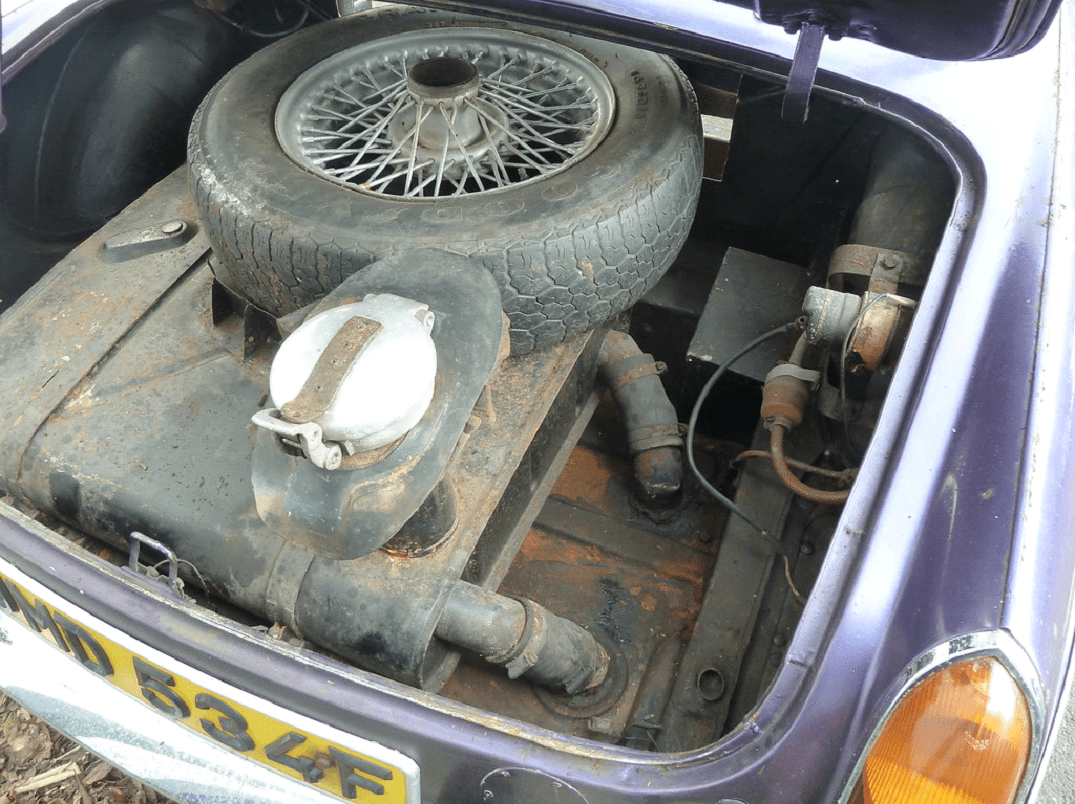

The addition of a second tank inside the boot with the spare wheel placed on it can be seen.
The cantilevered construction at the rear carried three 20 litre metal jerry cans. It would appear that one of them was reserved for supplying the crew with water by means of plastic tubes which joined the cockpit.
Second spare tire securely attached to the trunk lid.

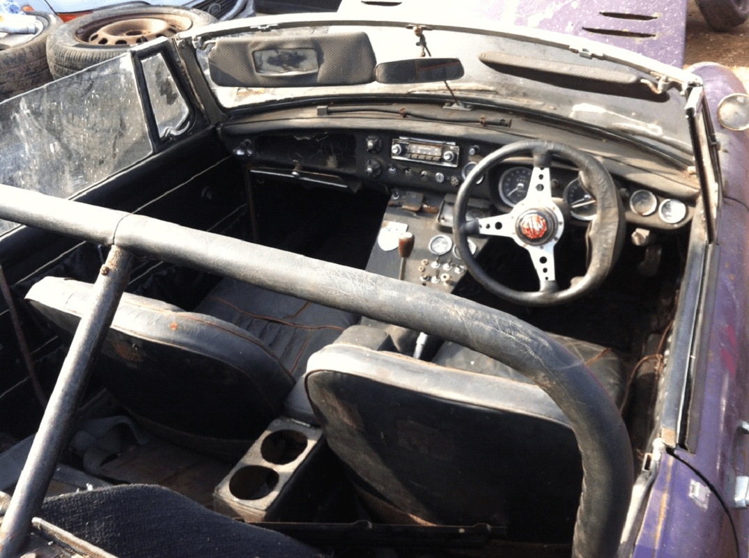

A successful finish at this type of event depends upon the mechanics, but this is nothing without the endurance of the crews. Minimum comfort – everything is relative! – is a necessary condition for ensuring crew performance. The hellish pace imposed for 10,000 miles on often rough supposes that the crew can recover on the move. The solution chosen: a high-back bucket seat to ensure good support for the driver, and to facilitate the teammate’s rest – a light bed in the passenger seat amounting to some back support allowing the co-pilot to perform as best he/she could when was awake. Unfortunately, these specific seats have not been found.
Tools and spare parts were secured under the seats.

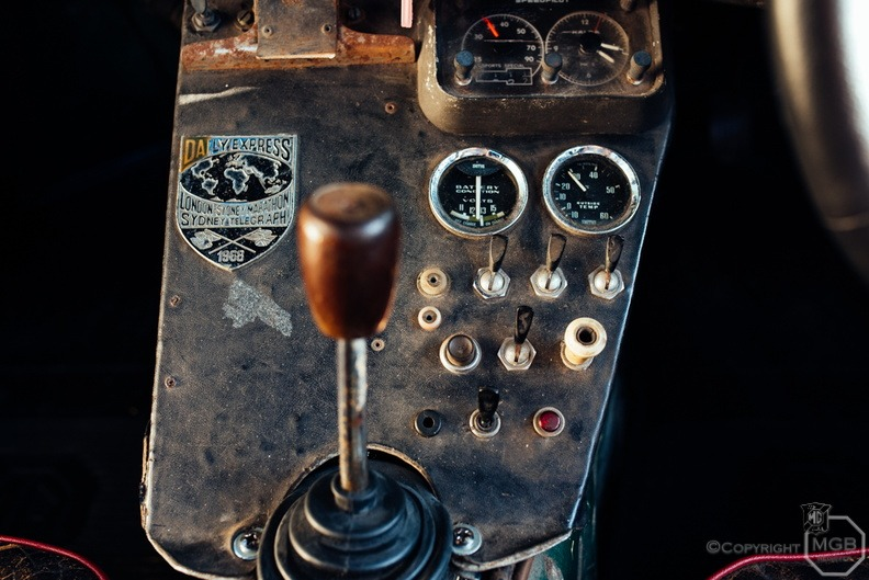

The specially designed console has a voltmeter, a Tripmaster, a clock and an external thermometer. A special antenna of 1.8 m. made it possible to receive the BBC’s Radio One music station almost everywhere.

Apart from a few finishing touches, the exterior is finished. There is still work to make the wiring harness more reliable, and the upholstery still needs to be restored as we can see in the photo.
